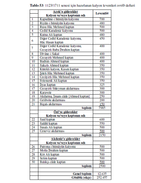

According to archival documents, there are 30 galleons prepared for the expedition in 1711. 5 of these galleons were commissioned in the Mediterranean. Of the remaining 25 galleons, 21 were sent to the Azov expedition, and 4 were sent to the Özü Fortress. The total number of assigned soldiers in these 30 galleons is 12,635.
https://i.postimg.cc/zXsZVgnS/Yeni-Resim.png

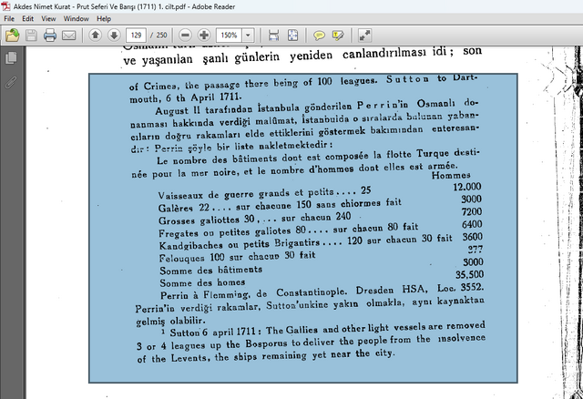

I think the reports of foreign ambassadors are more reliable than the data provided by our historians who lived in that period and recorded the events.
The report of the Polish ambassador about the Ottoman Navy on page 250 of the same work:
https://i.postimg.cc/BnBH2pWH/Yeni-Resim.png
